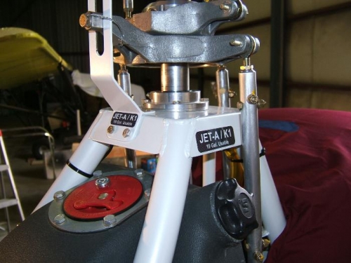

- Two Jet-A / usable fuel labels

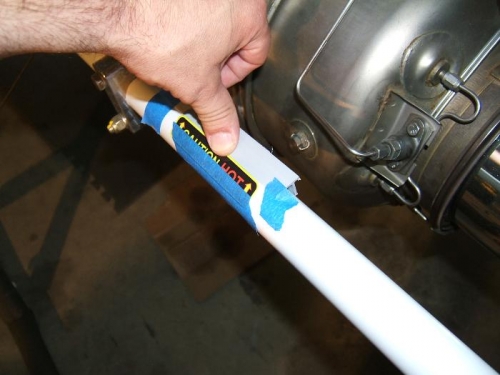

- HOT warning label near engine

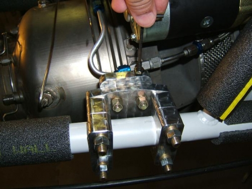

Lowered the rear engine mounts 1 turn to re-align the pulleys after having added a turn to the clutch clevis a couple weeks ago to bring the clutch pull up to 45 lbs from 35 lbs.
Jet-A labels
Jet-A labels
Appling warning label to frame
Lowering rear of engine to align pulleys
