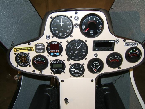

Removed the belts from the pulleys and fully extended the clutch then tightened the two bolts securing the lower bearing flange so the bearing will have its best alignment in this position. Applied torque stripes to the nuts and the bearing/flange interface so I can tell if the bearing ever turns in the flange.
Printed out my new labels on paper and cut them out to test fit them before I get them printed on vinyl.

Test labels and checklist checking fit
