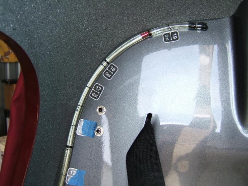

Applied fuel level labels along the sight tube.

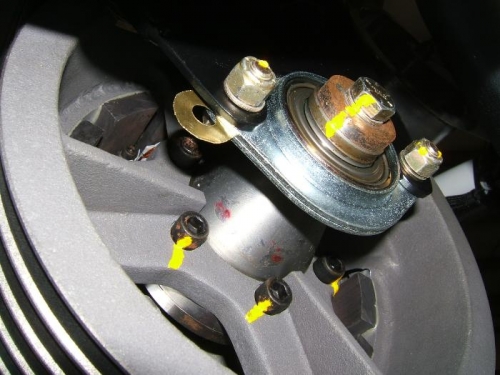

Cut a couple of .010" shim washers to go between the two halves of the lower clutch bearing flanges. This was suggested by Hap Miller to allow the bearing to self align as the front of the engine raises and lowers when the clutch is engaged. I have the shims in place but still need to re-torque the bolts with the clutch engaged so the bearing will be in its neutral position.
Worked on the new/additional labels now that I know the usable fuel. Also making some throttle and collective friction labels. Hoping to get them printed this week.
Labels taped in position, ready to stick down
Sight gauge labels
Sight gauge labels
.010
.010" shim washer ready to go between lower bearing flanges
