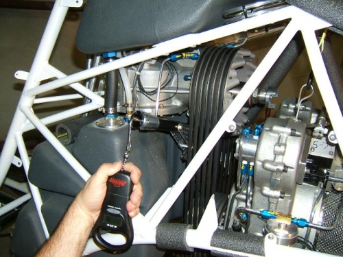

I had original adjusted the clutch engagement force to 35 lbs per the build video but recently received the maintenance manual which lists the clutch pull force as 45 lbs. So tonight I readjusted the clutch to 45 lbs which equated to one turn out on the clevis that attaches the clutch to the bottom of the transmission.
Reused picture from the first time I adjusted the clutch
