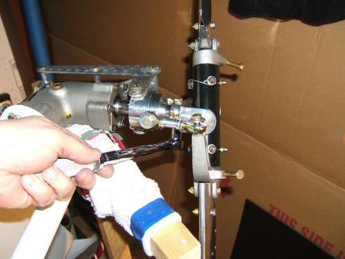

Final installed and torqued the tail rotor hub bolt that attaches the hub to the tail output shaft.

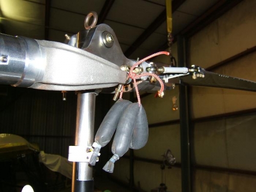

Made up a 3 lb weight from a bicycle tube filled with lead shot which was then hung on the pitch links while adjusting the drag links to re-level the blades per the build video. It was difficult to get repeatable readings with the digital level after shaking the head to let the blades find their level
so I got them as close as I could and will let the check pilot fine tune this as hopefully he has a better way of doing it or more skill in doing it this way.

Torquing the tail rotor hub bolt
3 lb lead-lag adjustment weight
Adjusting the drag link with the 3 lb weight
