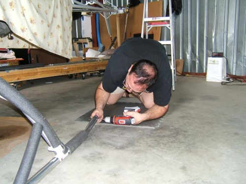

Drilled two 1/8" holes on either side of each skid end then counter sunk and installed flush pop rivets to secure the skid plugs in the skids.

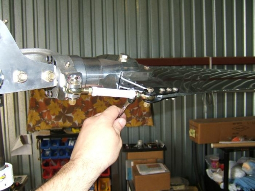

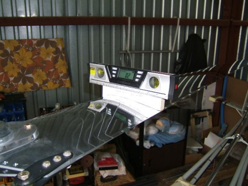

In preparation for static balancing the blades, I removed the pitch links and adjusted the drag links so the blade pitch is near zero when the head is shook so the blades will find their balance. The drag link adjustment is very sensitive so very small changes are needed.
Drilling rivet holes to secure skid plugs
Adjusting drag link to set blade lead-lag
Checking blade lead-lag with digital level
