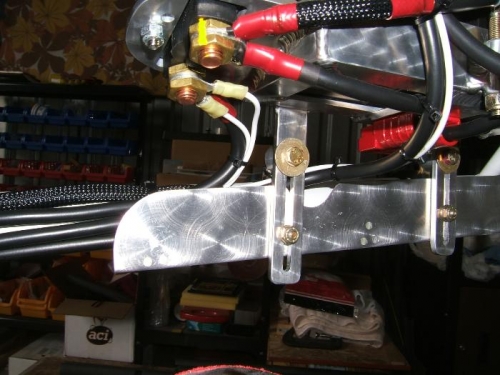

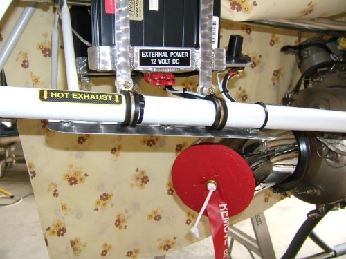

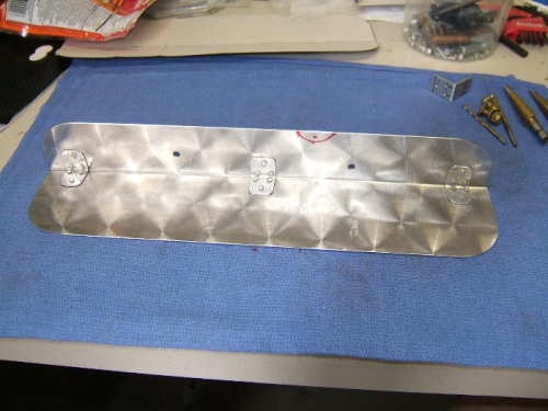

Brief Description:  Exhaust heat shield
Fabricated and riveted on three corner doublers to reinforce the exhaust heat shield since it had some cracking when it was bent in the brake. Cut out a half circle, clearance area for the battery wires. Installed the shield with two AN3 bolts through the bottom arms of the battery box leaving about a 3/16" gap between the bottom of the adel clamps.
Doublers riveted on to heat shield
Heat shield in place
Relief for wire clearance
