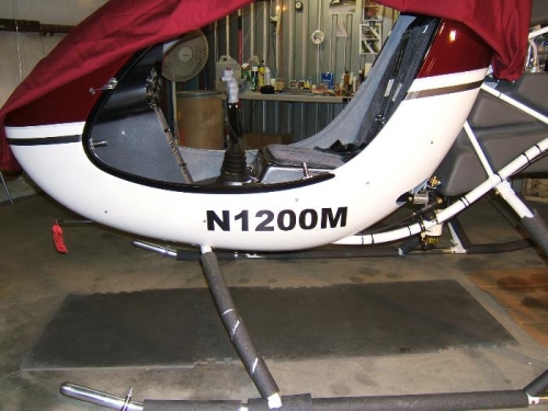

Bought some faux carbon fiber vinyl at the local sign shop and cut out N1200M on the vinyl cutter at work.

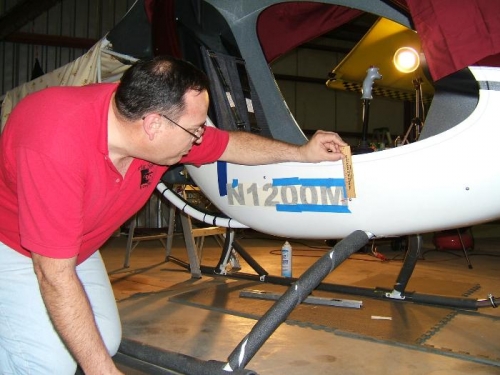

Spent too long getting the numbers lined up and matching on both sides, only wanted to do it once. Hinged the transfer tape along the bottom with masking tape, removed the backing and carefully hinged the whole thing back up working the characters from bottom to top. Luckily this vinyl is pretty thick and stiff so it didn't try to wrinkle on me.
Measuring to match position side to side
It's official
It's official

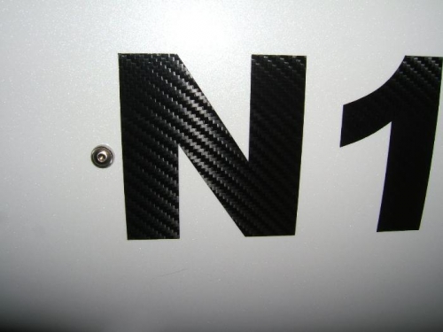

The carbon fiber look
