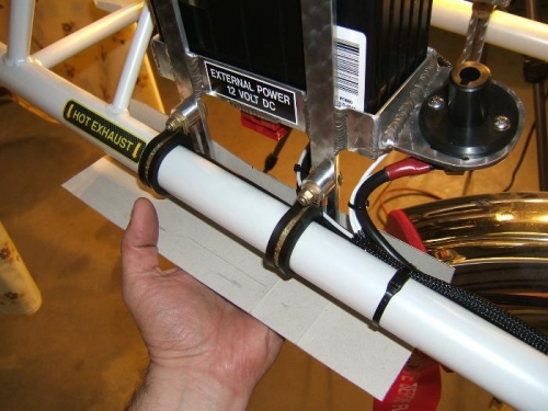

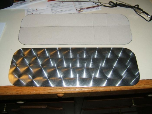

Began fabrication of the exhaust heat shield using the cardboard template I made yesterday to cut the shield from .032 aluminum, radius-ed the corners and smoothed the edges on the bench sander. Engine turned both sides of the sheet before bending the angle into it to make it easier.
Heatshield cardboard template
Engine turned, ready for bending
