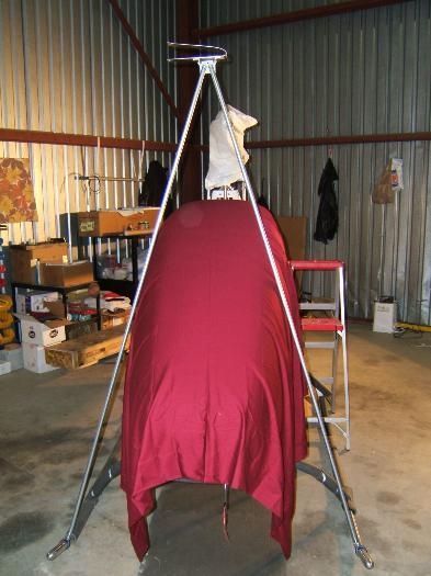

Finished up the front blade support by cutting the tubes to length, flattening the ends and drilling holes in them to bolt them to Adel clamps on the front of the skids.

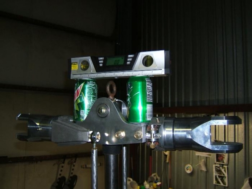

Tested a couple of high tech spacers that will let my level clear the center of the hub for static balancing.

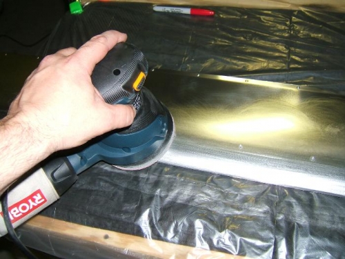

Started sanding the top of blade 2 with 400 grit on the orbital sander. Mainly sanding the front 1/4 of the blade and leading edge with the 400 to remove sanding marks left from the factory cleaning up the bond line. Next I'll use 800 grit on the entire surface then 1000.
Front blade support done
Prepping for static balance
Sanding top of blade 2
