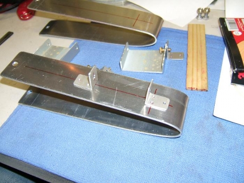

Brief Description:  Blade supports
Started fabricating a pair of blade supports that will be used to make blade installation easier and can also be used for short trailer trips.
Started with 2" wide aluminum strap and bent them into an oversize airfoil shape so there will be room for foam cushioning.
Cut some aluminum angle and channel that will get riveted to the bottom of the cradles and bolted to the support tubes I'll be making from 1/2" conduit.
Checking cradle shape
Cradle hardware waiting to be assembled
Ready to drill for rivets
