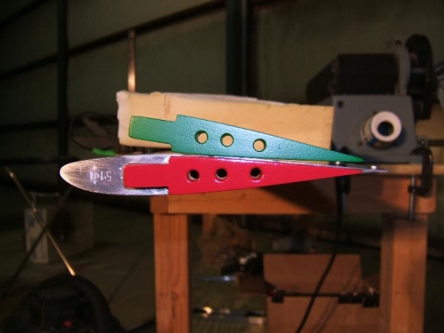

Painted the blade plugs red and green in an effort to enhance blade path visibility and help with blade tracking.

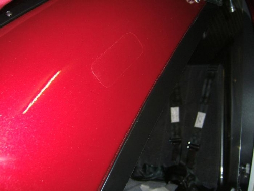

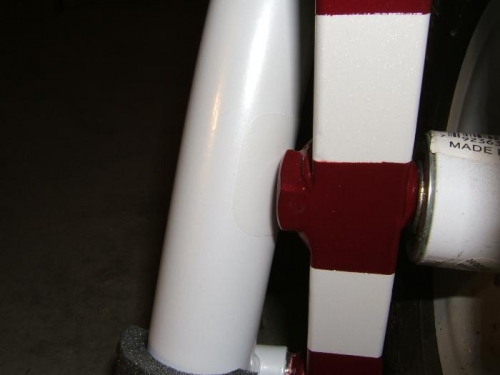

Applied 3M, 8 mil clear paint protection tape to the cabin where the left door contacts it when opened. Also applied tape pads to the rear landing gear where the ground wheels may hit during installation.
Painted blade plugs
Painted blade plugs
Door bumper pad
Door bumper pad
Ground wheels bumper pad
