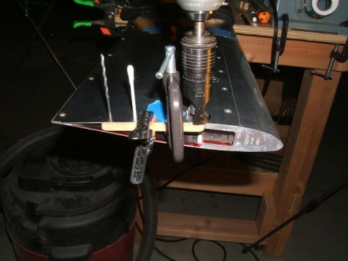

Continued work on the #2 blade plug.

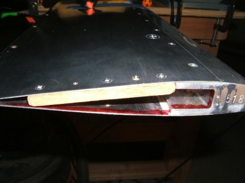

Marked and drilled the 5 top screw holes. Used a thin strip of oak as a backer with match drilled #40 holes to keep the counter sink centered. Clamped it for the first couple holes then installed a couple of the screws to hold it for the rest. Repeated on the bottom. These came out better than the other blade with only a couple screws needing slight filing.
Removed the plug indexing the screws as with the other plug so I'll be sure to put the shortened screws back in the correct holes so they won't hit with the screw from the other side.

Counter sinking the screw holes
Using a backer strip to keep the micro stop centered
