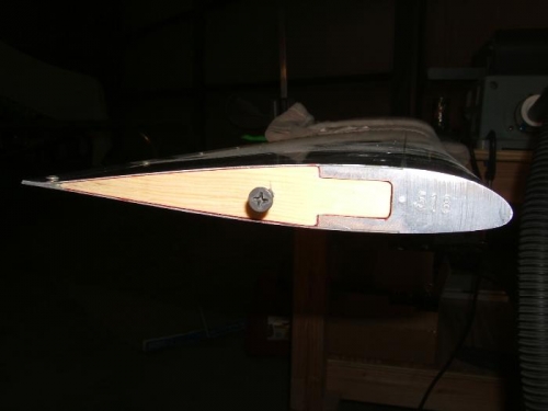

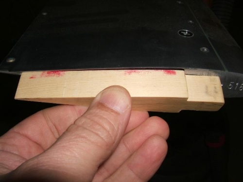

Brief Description:  Blade two end plug
Started work on the end plug for blade two. The plug from blade one is almost a perfect fit for blade two, as I expected it should be, so I used it as a template to mark the second plug then went to work sanding and checking the fit. I sanded this one mostly by hand since the sanding disc on my bench sander needs changed and it also gave me better control in shaping small sections.
I got the plug to where it slides in with just a little pressure and makes good contact with the skins.
