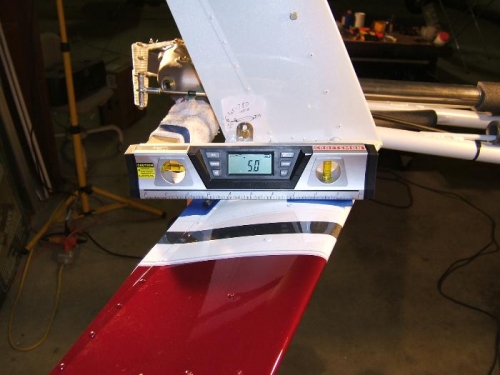

Set the horizontal fin incidence at 5 degrees using a .370 drill bit and the digital level zeroed to the main shaft.
Final torqued all the tail fin bolts being careful not to distort the thin spar tubes.

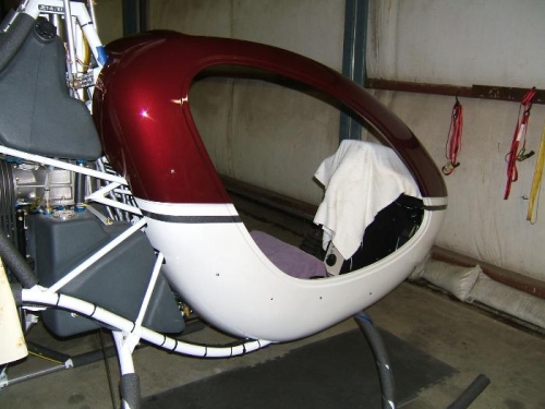

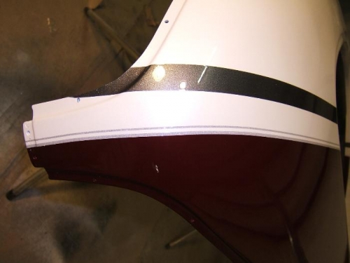

Pinstriped the right cabin half then installed it on the seat pan.
Horizontal stab angle set
Pinstripe on nose of right cabin
Right cabin half attached to seat pan
