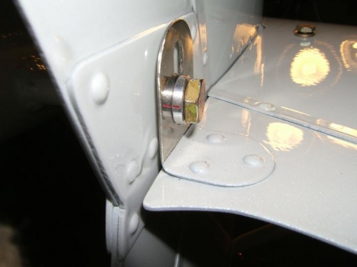

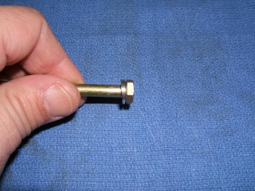

Made a tapered washer to go on the long bolt that secures the vertical fin to the frame and also captures the slider that sets the angle of the horizontal fin. The washer has an angle of 6.42 degrees which is .045" thicker on one edge.

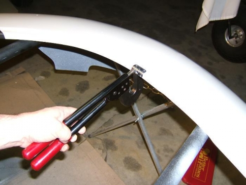

Installed the three door latch striker plates with four flush rivets each on the left door sill.

Installed the tapered washer and the remaining tail fin bolts and braces. Left the nuts slightly loose until I final adjust the horizontal fin incidence.
Custom tapered washer for long vertical fin bolt
Washer in place, mark indicates thickest point
Squeezing the striker plate rivets
