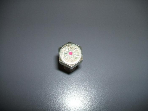

Brief Description:  Drive pin bolt, cyclic stick bolts

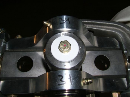

Turned a center dimple in the head of the bolt that secures the main rotor drive pin lock and put a drop of red nail polish in the dimple. Got this idea from Juan's build thread to make it easier to sight center the line when stringing the rotor blades later on. Reinstalled the bolt and just lightly tightened it since the head will be coming back off later.

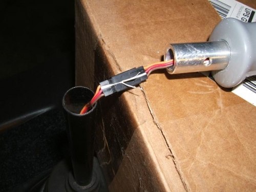

Used dental floss to secure the three pin wire connector that feeds the cyclic grip buttons.

Rotor drive pin lock bolt center dimpled
Lock bolt in place
Lock bolt in place
Grip buttons wire connector secured
