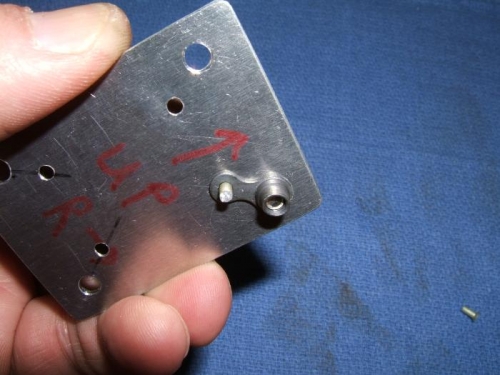

Started out by match drilling the slider base with the aluminum backer plate for #8 screws. Cut one ear off of four nut plates and riveted them to the backer plate.

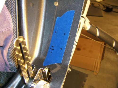

Attached the slider to the collective and found the mounting location that centered the total travel in the slider slot. Marked then drilled the holes through the fiberglass seat pan.

Adding nut plates to the backer plate
Marking the holes to mount the friction base to the seat pan
