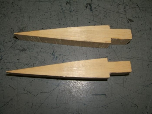

Rough cut the wood plugs for the main blades.

Blade plugs rough cut
