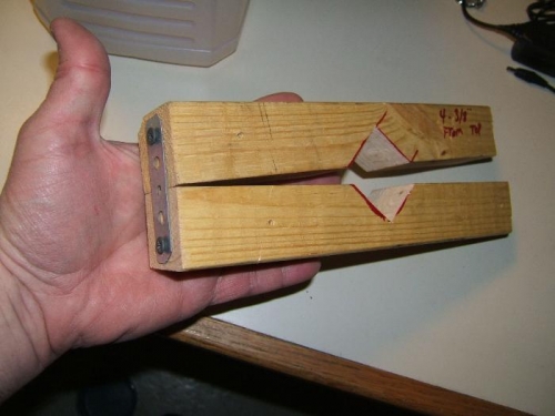

Made a V block clamp to grip the main shaft so I can set the rotor head on it while I get things lines up and pinned.

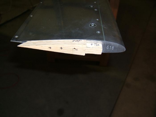

The original owner had started cutting out a blade tip plug but the wood split at the thin trailing edge. I will use this first attempt as a template to make the two tip plugs.
Clamp blocks to support rotor head during assembly

Blade tip plug first attempt
