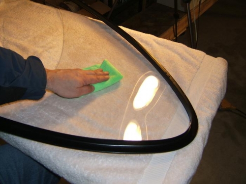

Cleaned and polished the plexiglass of the two doors. Used Novus plastic polish to remove the faint markings left by the masking tape along the edges of the windows and cleaned them overall with Novus cleaner.
Re-assembled the latches onto the left door using loctite on the screws. Re-installed the hinges on the left door using locking nuts but will not tighten them completely until final fitting on the cabin since there is a little play in the holes that can be used to get the best alignment of the hinges.
Cleaning/polishing left door
