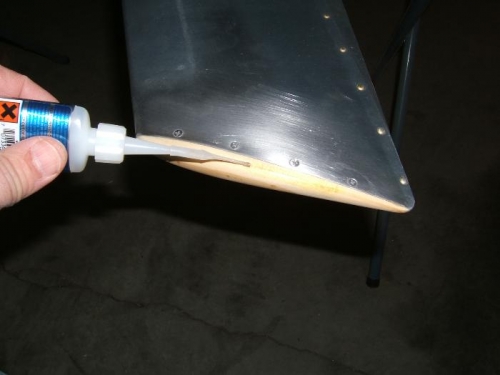

Soaked the vertical fin end plugs with CA glue to seal them before painting then final sanded.

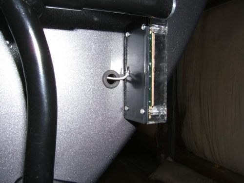

Drilled holes in the sides of the pod behind the LED strobes for the wires. Installed rubber grommets, routed the wires inside, connected and secured them.
Soaking the wood fin tip with CA
Hole and grommet for strobe wire
