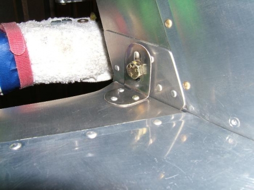

Removed the cabin halves and used the small drum sander in the drill to open up a little more room in the areas around the lower frame tubes and to create a cutout for the fuel line that attaches to the bottom end of the sight tube in the cabin.
Used the rivet squeezer to install three rivets attaching the angle bracket to the trailing edge of the horizontal stab. Verified the fit and checked the range of incidence adjustment for the stab using the digital level, +2.5 to +6 degrees.
Removed the horizontal stab and applied thin CA glue to the wood end plug to soak in and seal the wood, sanded and applied a second coat.
Squeezing rivets
Squeezing rivets
Rear stab bracket installed
