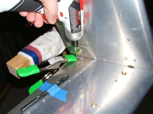

Positioned the rear stab bracket and match drilled three rivet holes into the trailing edge of the stab.

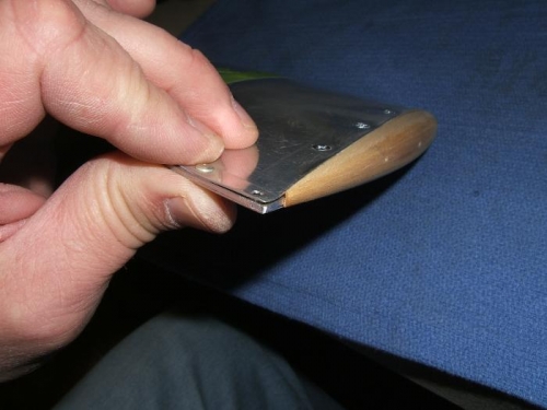

The top skin at the outer rear corner of the horizontal stab was lifting up from the trailing edge strip and the last rivet was over an inch from the end. I drilled a #40 hole near the end and installed another rivet then radiused the corner to prevent it from getting snagged and bent.
