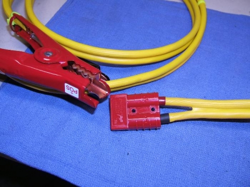

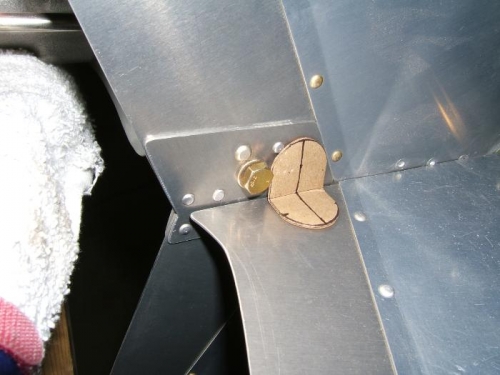

Brief Description:  External power cable, Horiz. stab mount
Bought a set of jumper cables, cut them about 2 feet from one end and installed the other half of the Anderson Power connector to mate up with the external power connector mounted under the right battery box. I have ordered a third connector to install on the other end of the jumper cables so they can be reconnected and still used as normal.
Made a template for an angle bracket to be riveted to the rear of the horizontal stab with the long vertical stab bolt passing through it to lock in the horizontal stab's angle of attack rather than relying only on the bolt through the stab spar.
Power plug installed on jumper cables
Connected
Connected
Template for horizontal stab bracket
