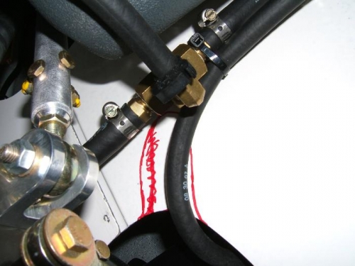

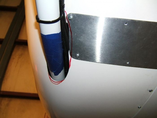

Put a few more screws in to secure the two cabin halves together then marked three places that need a little extra trimmed away for clearance of the fuel lines and wiring. Trimmed the rear aluminum cover plate with heavy scissors then cleaned up the edges on the belt sander. I'll use a a drum sander in the drill to trim up the fiberglass cabin when I take the halves back off to take them for paint.

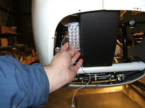

Decided on a mounting location and wire routing for the two LED anti-collision lights. I'll mark the locations but probably won't be able to final mount them until the cabin is removed again.
Marking for a little extra clearance
Cut out for the sight gauge hose
Positioning anti-collision strobe
