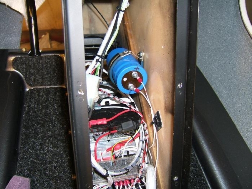

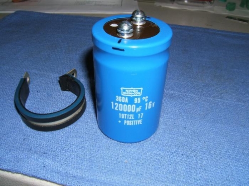

Received the large capacitor from Digi-Key today so I decided on the mounting location inside the pod, cut the wires to length that I had previously installed and installed the ring terminals.
Tested the operation of the capacitor and found that it will only power the fuel flow meter for about 2 seconds once the main power is cut but the engine tach stays on much longer.
Started looking at possible routing and locations for the radio antenna.
120,000 mf 16v capacitor
Mounted and wired
Mounted and wired
