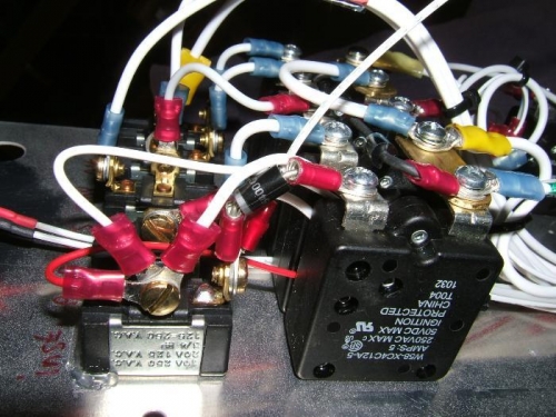

Brief Description:  Instrument power diode, anti-torque pedals
Decided to add a diode and large capacitor to the instrument power circuit to maintain sufficient voltage to the instruments when the starter is engaged. Currently the fuel flow gauge and engine tach reboot from the voltage drop caused by the starter. Placed the diode between the breaker and switch then added a wire to the input side of the switch which will be connected to the + side of the capacitor which I'll install inside the pod when it arrives from Digikey.

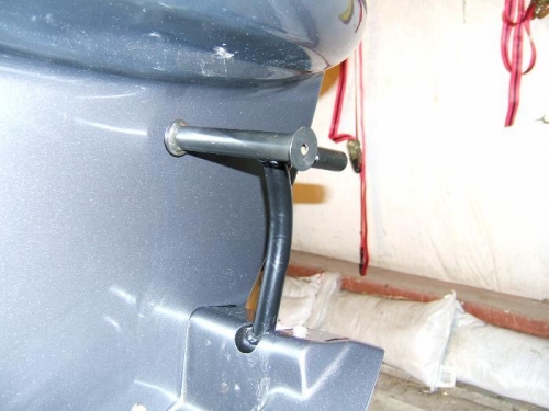

Sat in the seat to determined the best position for the anti-torque pedals which have holes for three different positions. They just need a coat of paint then can be final installed.
Instrument diode and capacitor wire added
Anti-torque pedal
Anti-torque pedal
