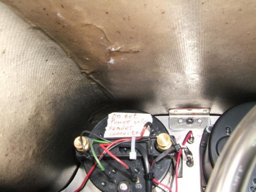

Placed the instrument panel into the pod and used the camera to reach inside the pod and take pictures of the back side of the panel to check clearance of the mounting tabs. Found that two of the tabs needed a little trimmed off the corners.

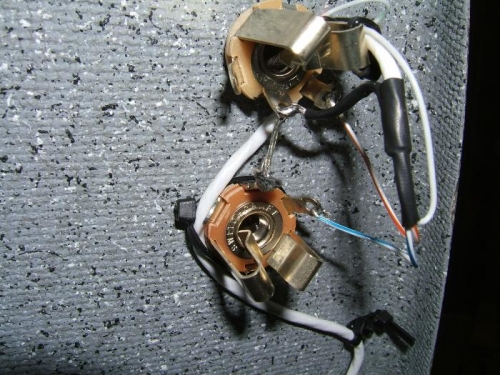

Sat in the seat with the headset on to determine a good location for the headset jacks. Decided to place them over my right shoulder. Marked and drilled the two holes, installed the Mic and Phones jacks. Routed the wires to the back side of the jacks, secured them to the jacks with zip ties and soldered.

Top panel mount hitting ASI

Phone and Mic jacks installed
