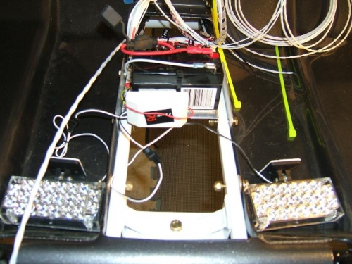

Brief Description:  Anti- collision lights

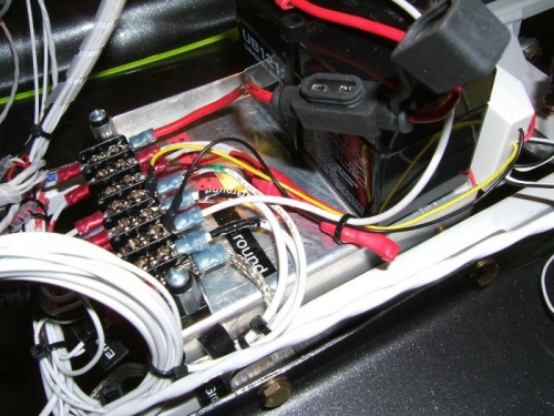

Installed the controller for my LED anti-collision lights that will be mounted behind the chin window. Wired the lights to the main power bus at the terminal strip. The LED Wig-Wags pull 100 mah and will turn on with the battery disconnect which should remind me to turn it off.
Wig-Wag wiring
Wig-Wag wiring
Anti-collision LED strobes
