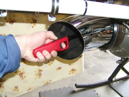

Terminated the exhaust temp wires at the meter then verified operation using a lighter to heat the probe in the tail pipe.

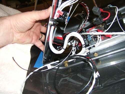

Bundled and routed the switch and power wires to the lower panel leaving slack to allow the panel to tilt out against the seat for access.
Attached a small adel type clamp to the back side of the panel to secure the wire bundle and provide strain relief.
Testing the exhaust temp probe

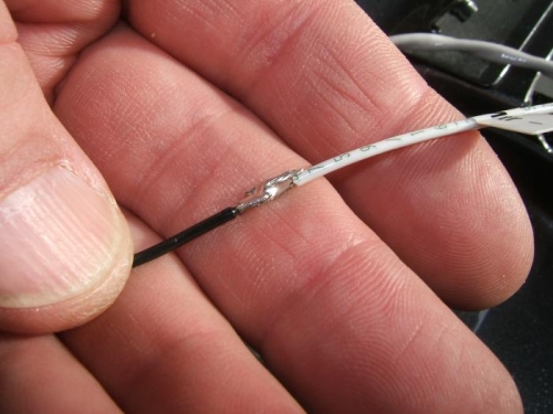

Wire splice joint to the exhaust temp gauge
Wire bundle attached to the lower panel
