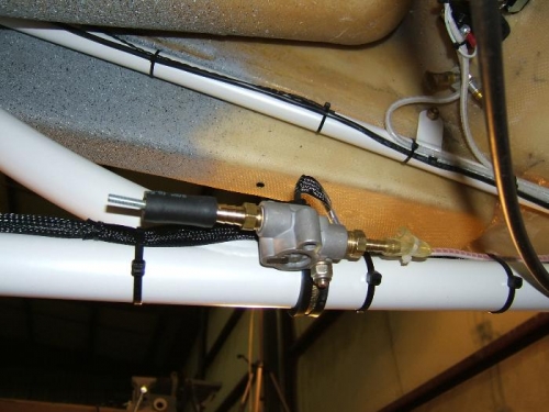

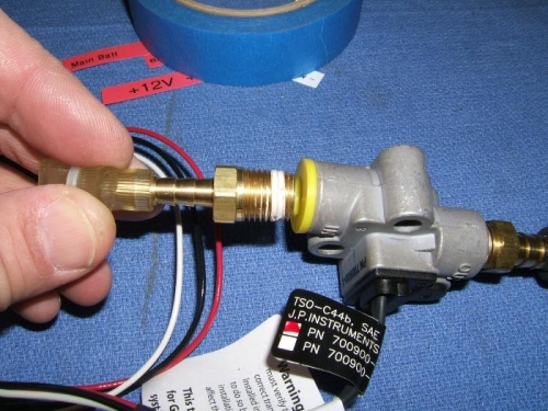

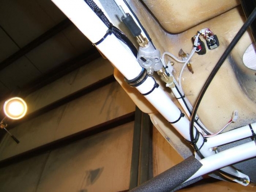

Decided on a mounting location for the fuel flow transducer along the left frame rail and attached it with an adel clamp.
Now ready to hook up the last three fuel lines from the pump to the valve, from the valve to the transducer and from the transducer to the engine's high pressure pump.
Before I connect the fuel line to the transducer I will put some fuel in the tanks then pump it out through the all the plumbing up to the transducer a couple of times to hopefully clean out any debris so it won't end up jamming the small turbine in the transducer. Then I'll connect the line to the transducer and run the fuel through again to flush out the line between the transducer and the engine pump before connecting it to the engine.
