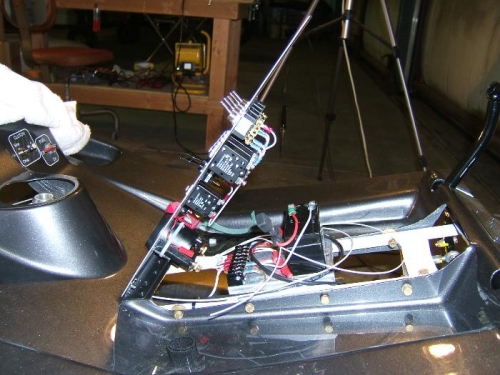

Temporarily attached the lower panel to check clearance and plan out wire routing.

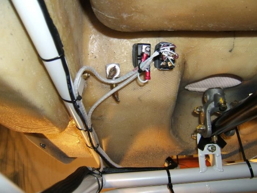

Spent a lot of time organizing, routing and securing the left side wire bundle and clutch switch wires.

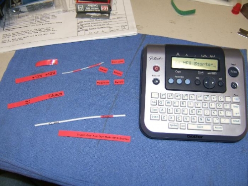

Used a label maker to make up wire labels, red labels for wires connected to +12v, black labels for wires running to ground and white for gauges and others. Verified wire destinations with an ohm meter and applied labels.
Lower panel
Lower panel
Making wire labels
Making wire labels
Left side wires and clutch switch
