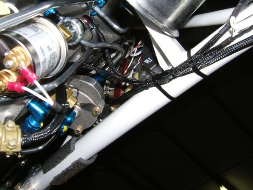

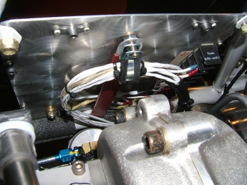

Finalized left side wiring up to the cabin and final mounted the governor. Fabricated an aluminum strap that attaches to the back of the governor to hold the wires down and prevent them flexing at the connectors.

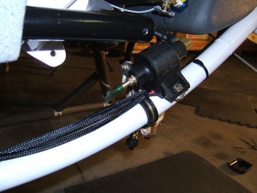

Soldered leads to the fuel pump and routed to the panel area and connected the ground lead to the terminal strip.

Back of governor box, wire hold down strap
View of governor wiring from below
Fuel pump
Fuel pump
