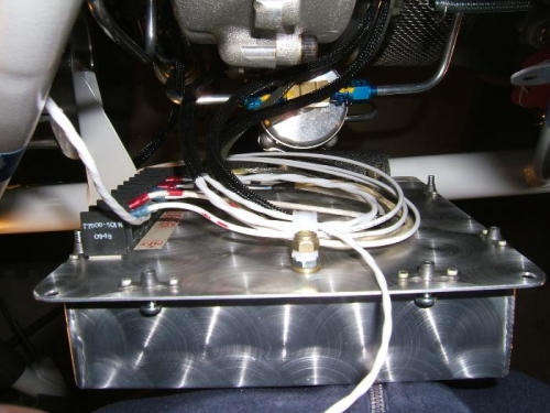

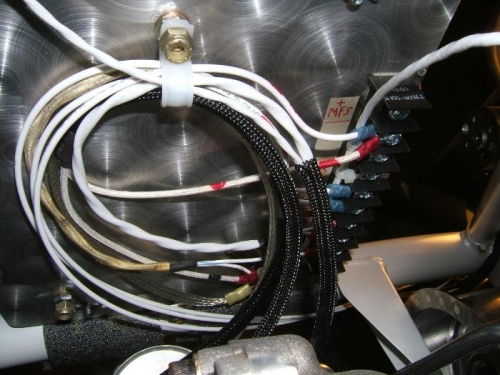

Brief Description:  Governor wiring
Cut wires to length and installed ring terminals to connect the throttle servo, MFS, engine RPM sensor, grounding strap and power wires to the governor. Left the wires long enough to form a loop on the back of the governor box for strain relief and slack as the engine moves up and down during clutch engagement.

Top view of governor wires
Back side of governor
