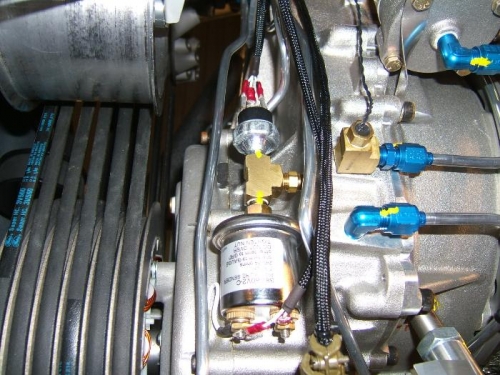

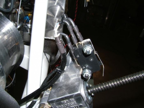

Made up the wiring for the clutch position switch, the oil pressure sender, hour meter and the oil pressure switch.
The hour meter ground is wired through the clutch micro switch and the oil pressure switch so the meter will only run when the engine has oil pressure AND the clucth is engaged.
Clutch position switch wires
Oil pressure switch and sender
