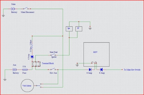

Made a cardboard template for an aluminum plate to mount the small backup battery in the bottom of the instrument pod. The plate will bolt in with four of the pod bolts and will also have a terminal block mounted on it.
Drew up schematics for the aux battery circuit, the hour meter and the panel LEDs.
Aux battery wiring
Aux battery wiring
