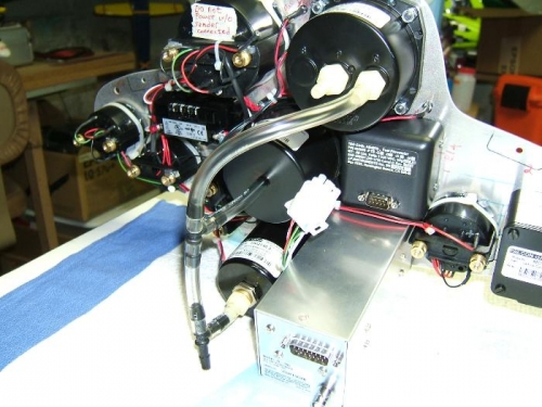

Static pressure plumbing
Threaded hose barbs into the ports on the airspeed and VSI. The altimeter static port hole is not threaded but the hole size is a tight friction fit for the vinyl tubing. Cut and installed the vinyl tubing and T's.
Static plumbing
