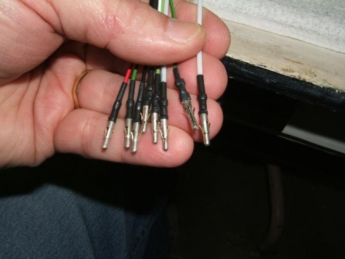

Added the three conductor sender wire to the rotor tach then installed connector pins on the 8 wires that go to the 9 pin connector included with the kit. Crimped and soldered the pins to the wires and added heat shrink for some added strain relief.

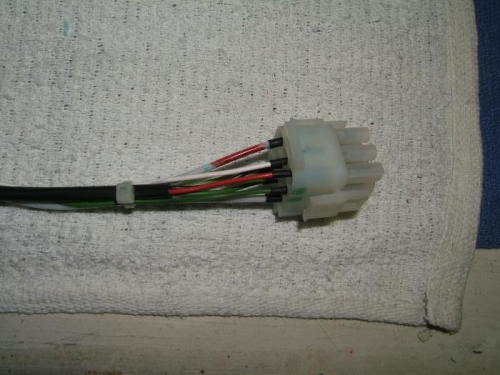

Plugged the pins into their assigned positions in the connector according on the provided wiring diagram.

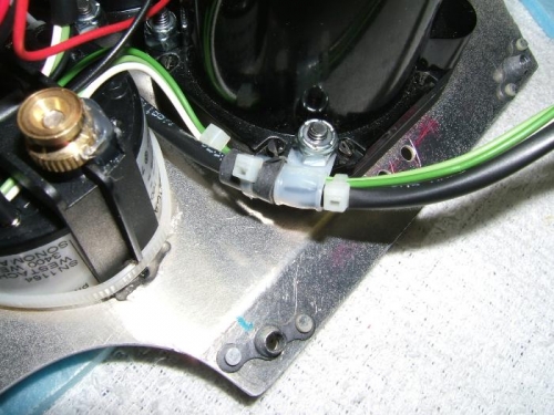

Attached the bundle to the lower screw of the ASI for strain relief.
Installed connector pins
Completed connector (panel side)
Strain relief
Strain relief
