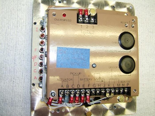

Brief Description:  Governor wiring

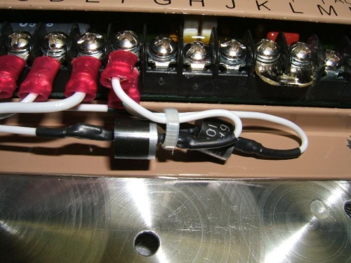

Finished installing the governor jumper wires including the main and aux power wires with diodes soldered inline to isolate the two power systems from each other in case of a short.
Only thing left on the governor is to add a hole and rubber grommet in the back plate for the small 3 conductor wire from the throttle pot.

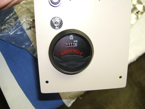

Mounted the hour meter in the lower panel.
Diodes in main and aux power lines
Finished and secured
Hour meter in lower panel
