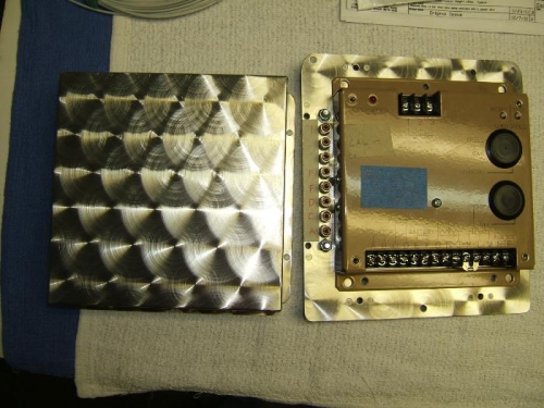

Jeweled the aluminum, RF governor enclosure box and governor mounting plate. Installed the 8 port RF filter strip into the mounting plate and bolted on the governor.

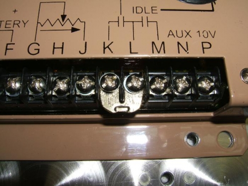

Made up a jumper to connect the K & L terminals per the wiring diagram.

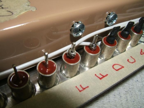

Started fabricating jumper wires from the RF strip to the governor terminal strips using 20 gauge wire and #6 ring terminals with the other end wrapped and soldered onto the RF filter posts.
More engine turning
More engine turning
Jumper tab
Jumper tab
Soldering wires to RF filter
