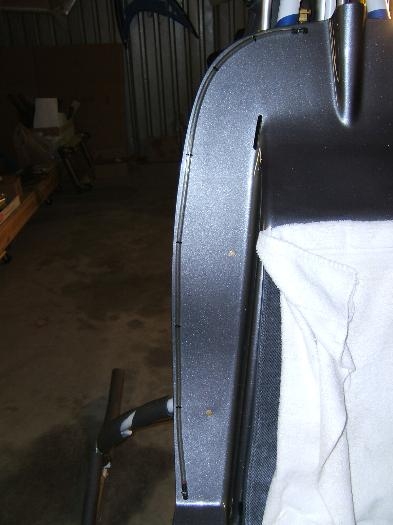

Finished installing the fuel sight gauge to the seat pan.
Connected the back sides of the elbows to the fuel tanks and secured the hoses with safety wire clamps.

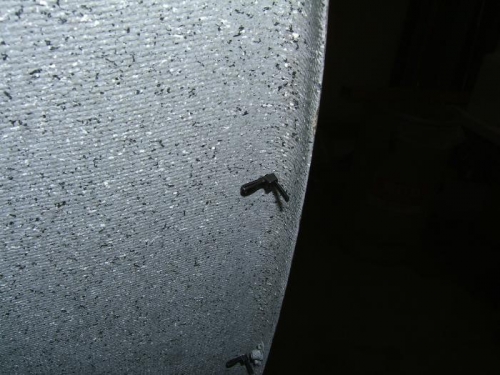

Marked and drilled six 1/8" holes along the edge of the seat pan, fed zip ties through from the back side around the tube and back through the hole to secure the sight tube to the seat pan.

Zip tie securing sight tube
Ready for fuel
Ready for fuel
