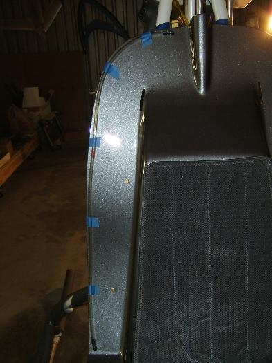

Applied Jet-A/K1 and external power labels.

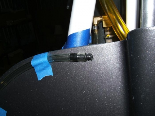

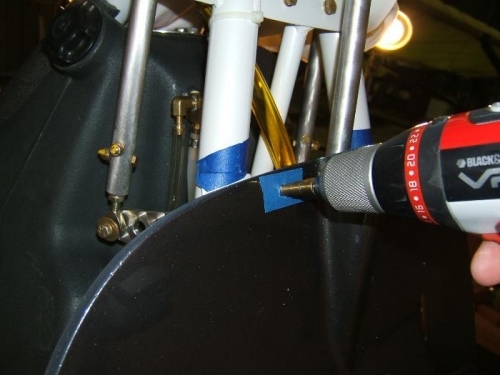

Began installing the fuel sight gauge on the right side of the seat pan. Drilled holes at the top and bottom, installed 1/4" elbows with the sight tube attached, connected the back side of the elbows to the fittings on the fuel tank. Need to decide how I want to secure the sight tube to the seat pan.
Drilling 5/16
Drilling 5/16" hole for the sight tube elbow
Upper end of sight tube
Replace the tape with clamps and it's done.
