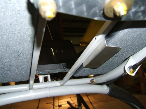

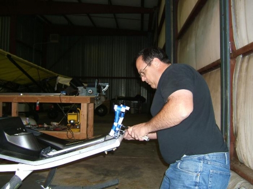

Final installed the 10 seat pan bolts using various thick and thin washers to compensate for varying fiberglass thickness.
Marked and drilled two holes in each of the angle pieces I'm installing to add support to the center portion of the foot wells since the bolt holes in the fiberglass are very near the edge and wouldn't be able to support much weight. Used various washers to shim the gaps between the foot wells and the square frame tubes so when the pod is installed the bolts will tighten against the frame without deforming the fiberglass edge of the foot wells.
