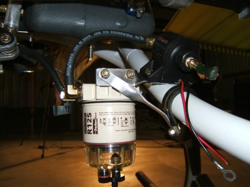

Filter mount brace
Fabricated a brace to stiffen the fuel filter mount so it won't shake and fatigue the pump mount welds. Final mounted the pump and filter.

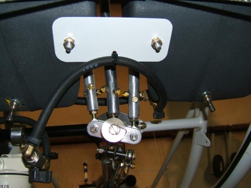

Installed clamps on the fuel line and secured it to the tank spreader plate to keep it from interfering with the cyclic control tubes.
Brace in place
Hose secured
