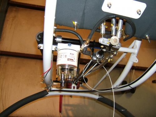

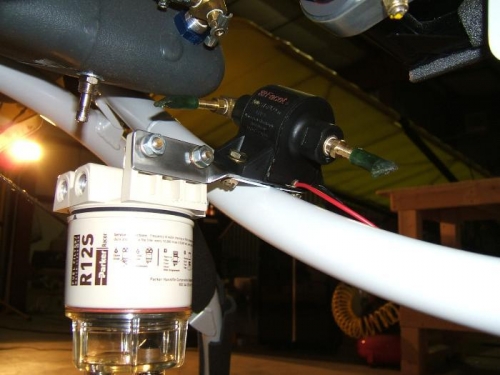

Brief Description:  Fuel filter mount & plumbing

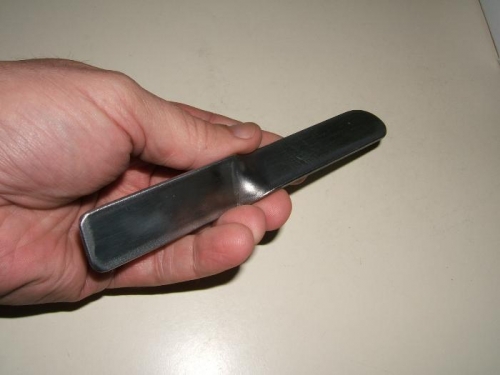

Fabricated a mount for the fuel filter/water separator from 3/32" steel strap that hangs it off the side of the fuel pump mount. Installed fittings and a shut off valve on the filter and cut the hoses to length. I think I will add a brace from the outer bolt back to a clamp on the frame to prevent vibration from breaking the pump mounts where they're welded to the frame.
60 degree twist
60 degree twist
Hoses attached
Hoses attached
