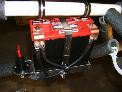

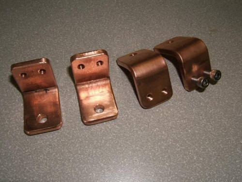

Fabricated four 90 degree, copper straps (3/16" thick by 1" wide) to allow the battery wires to be attached on the side of the battery for a cleaner install that also allows the wires to be better secured against vibration fatigue.

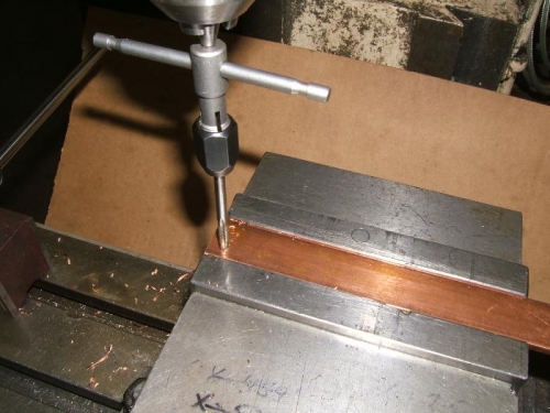

Tapped two 10-32 holes in each strap for attaching ring terminals, bent the straps to 90 degrees on a brake at work, and drilled a 6mm hole for the battery post bolt.
Tapping 10-32 holes
Tapping 10-32 holes
The finished parts
The finished parts
Installed
Installed
