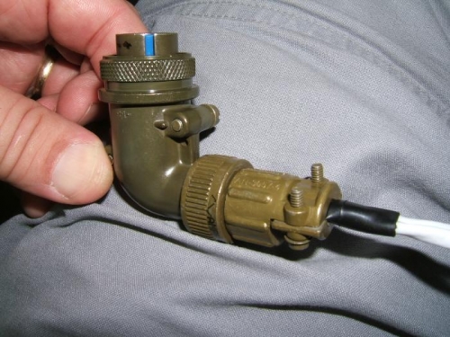

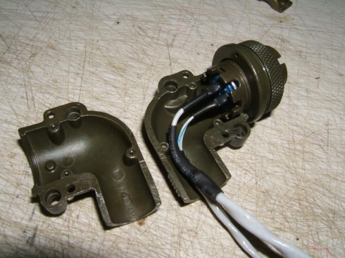

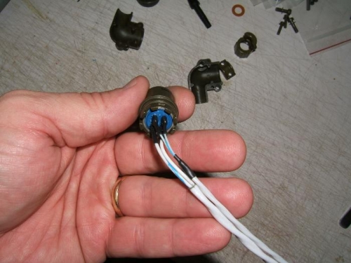

Soldered two 2 conductor shielded wires to the right angle connector for the engine RPM dual output sensor, the short 18 gauge will feed the governor and the longer 24 gauge will feed the digital tach in the panel. Assembled the case and installed the strain relief and connected the plug to the sensor on the engine.

Wires soldered and heat shrink in place
Ready to put the halves together
All buttoned up
All buttoned up
