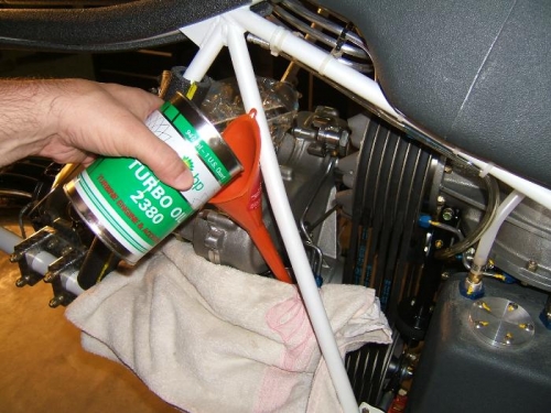

Took one last look at all the oil lines and fittings then added the first quart of BP 2380 turbine oil and was glad to find that the oil is easily visible in the sight gauge.

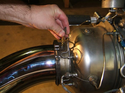

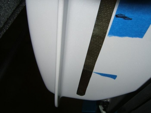

Used a drill bit through the exhaust temp probe hole to mark the location for the matching hole in the tail pipe. Removed the pipe and drilled a 1/4" hole, final installed the pipe, torquing the clamp to 25 in/lb per the instructions. Installed the exhaust temp probe but still need to safety wire it.
The first quart
The first quart
Sight gauge works! even in the dark hangar
Marking for the temp probe hole
