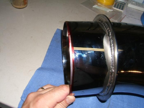

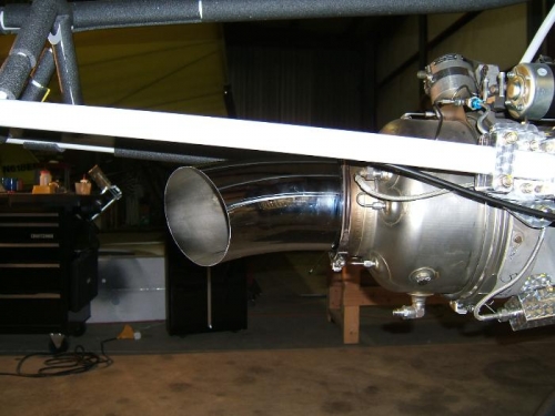

Used masking tape and then a sharpie marker to see where the tail pipe was contacting the exhaust chamber then used the table top belt/disc sander to grind a very shallow bevel on the edge of the pipe to allow it to slide in further getting the gap between the flanges down to about .040". Installed the pipe with the clamp and snugged it up to where I can just still turn the pipe while I decide on the turn down angle. Too low and I'll burn the grass during spool up, too high and I'll burn the lower frame tube, wires etc.. I currently have it at about 21 degrees down from horizontal, I'll check with some Helicycle pilots to get their opinions now that they're flying.

Marking the edge for grinding
Clamped in place determining turn down angle
